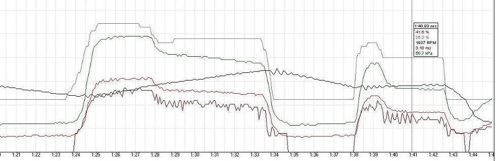

That log looks pretty good, too. Maybe slight evidence towards the end of that one as well...one about the same range I saw in your first log and one at a slightly lower mpa (50 kpa and 2000 RPM).
Did you notice any jerkiness in your drive at all, specifically towards the end of the log above where the IPW is jumpy? If not, email me your ROM and I can maybe test it out to be sure it's nothing in my ROM or another patch.
Maybe the issue does exist for you, but at a slightly different map range? Or maybe you don't have the issue or it is small enough not to be an issue. Either way, I wouldn't mind testing your ROM and seeing more logs.

OK, I analyzed a few more logs from logic as well as used his ROM on my car, just to make sure nothing in my ROM was the culprit.
Even with his ROM, I still experienced the issue. The issue is definitely subtle and maybe some just don't feel it for some reason, but it's there and the jumpy IPW shows in the log to prove it.
Upon analyzing logic's logs (as one is shown in the screenshot two posts up), it appears that he actually is experiencing the same exact issue I am. His IPW jumps seems to be about 50% smaller in amplitude, but I believe that's because his injectors are about 50% bigger than mine. I'm still on stock injectors, but I'm about to install the Bluemax 1250s.
So, now the question is, why do I feel this issue and logic doesn't? Maybe I just cruise in the range more often and am more used to this particular area being smooth? Maybe the larger injectors help lessen the effect that I can feel in my car? I don't know...I'm a bit stumped. All I know is that the IPW seems way more jumpy using the SD patch in that specific map/rpm range on both my logs and logic logs, as well as gear head's log from a few pages back. Why I can feel it, I think gear head can feel it, and logic can't stumps me. Heck, the whole reason why the IPW is so jumpy in that range stumps me.
I'll obviously continue to test and also see if the new injectors help relieve the problem on my car, but I'm still curious as to why it is actually happening.
I think it would be great if we can continue to have development for the SD patch (I guess this would have to be mrfred with John working on the GTR now) to incorporate maybe a 3D VE table and a few other possibilities.
One thing I have in mind (if this issue actually does turn out to be a widespread issue) is to have a table that sets a specific IPW for map and RPM, or load and RPM, or whatever. Maybe have this table only looked up for a map or RPM range that you can set or otherwise continue on with normal code. That's the only way I see this issue being resolved. That way I can say at 70 kpa and 2000 RPM, I want 3ms of IPW. I don't know...is that doable? What do you guys think? mrfred?
