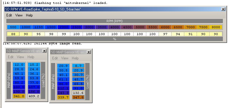

The easiest thing to do would be to take the map vs load table and do some multiplication on the load table to compensate for the stroker say add 15% should be pretty close. You can highlight the whole table and press the * key and use 1.15 to add 15% to all the values. If its rich revert and add only 10%

well i calculated the ve by using the 100*load/map, and i am getting ve's ranging form 65% at idle to 130% at 4500 rpm....its going to be hard to dial in the map/laod table
I tried that initially but it honestly didn't help me much in the end the values ended up being really close to what banks set to begin with for VE.
Here's what i mean by the map load table the one on the left would be a stroker setting. Its just a straight 15% difference.
Edit:
I noticed the left hand columns don't match just ignore that fact I forgot to copy it when i was setting this up as a demo.
