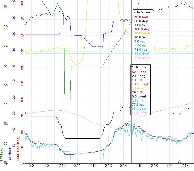

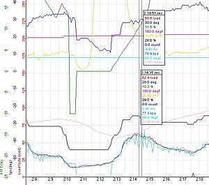

96530706 + DMA +LiveMap + SD - working
Its in my Galant. wiring isn't the issue.....i have been running 9055 for the past 6 months without any issues. Can you send me a copy of your rom so I can try it out?
OK, I did a log with 16 bit map and it's still pretty smooth during the jagged IPW. The 16 bit map varies maybe by 1-2 kPa. So. something isn't quite adding up.
Just for testing purposes, I turned off Tephra's map averaging and reworked my VE tables to try to even more closely match my MAF logs. The issue did seem to become a little less noticeable, but the logs still show the jagged IPW for no apparent reason.
I will read through the original SD threads, but how is the IPW calculated with the SD patch, so that I can log everything and see what is the cause? Here is a screenshot of a log with the 16 bit map. In 0.15 seconds, the IPW goes from a low of 2.80ms to a high of 4.40ms (shown in the boxes in the screenshot). In 0.08s later, back down to 2.80ms, and then 0.08s later back to 4.40ms again. The MAP shows about a 1.5kPa difference and the RPM shows about a 50 RPM difference. Everything points to the fact that the IPW should be the same, yet it is jumping up and down like this. Once I get out of the culprit RPM/MAP range, the IPW smooths out. At idle, it is dead flat.
Does anyone else running SD see this issue at all? Mind posting up a log of a cruise going through low to high RPM, lower to higher map?

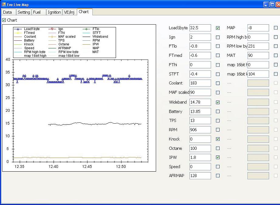

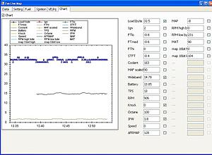

OK, here is my latest revision of the LiveMap exe. Just copy this to the folder you are running your current LiveMap from and run this exe instead. I'm still going to go back and change the colors of the curves to make sure all are dark enough to be read, maybe get rid of or add different line symbols, etc, but for now, this should help you with charting, and at the very least, with live data display.
Here are couple of screenshots to show what is going on. First is my Data tab, which shows the config table. Notice the entries in that table. The second screenshot is the chart tab, which labels the curves and live display text boxes based on that table. The evals also come from that table. The checkboxes next to each live display data text box is whether you want that data charted or not.
Eric

Thanks for the updated live map app, it's much better being able to select the graphed items. I only wish I knew some VB programming so I could add some useful updates myself rather than relying on others to progress the development of this.
