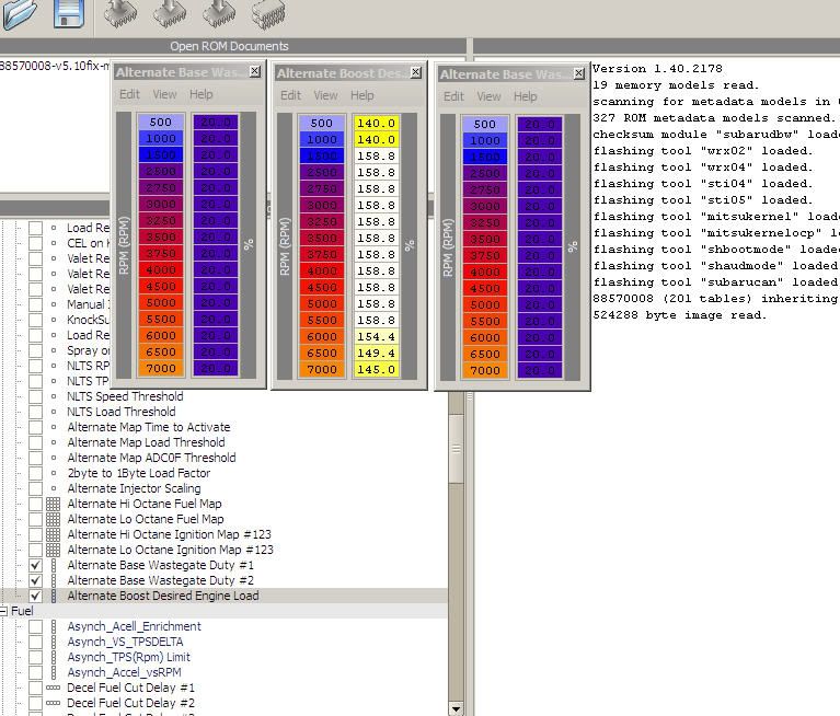

so i tried the speed density today, NO CELs YAY!
car idled well - did not get a chance to drive any distance however for some reason the WGDC tables are not working in the Alt MAP it was set to 20 throughout and now i am hitting 29 psi here are my maps, first is the Alt Map:
then the Normal boost maps:
before i only hit 12psi (wastegate) on the 20 WGDC and 18 psi on 50 WGDC
BTW u have the address for desired idle drive RPM? i tried some HEX addition/subtraction as you can see it did not work out
Thanks!

I take it you're not using the xmls I gave you for the SD stuff?
(use the evo9base xml i sent you too)
I only ask as the Wastegate duty tables are different (there's some repetitions), and the boost enhancement-antilag junk is still in there
Can't help you righ tnow on the other stuff as I'm on a diff laptop, but I'd check the addresses for the Max Wastgate tables to see if they're the same.
I'll check the idle when i have access to my other laptop, prob not for another couple of days.
thanks again!
i am using ur evo9base, but the address in the xml is missing dont know why!
i need to sort out the boost issue, i will post in tephra's mod as well. it should not be happening. keep me informed on any breathroughs u get.
