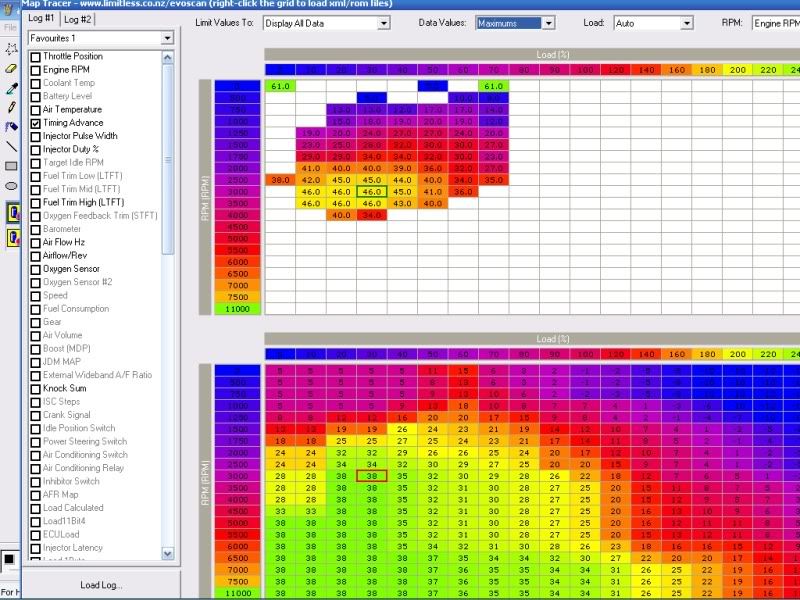

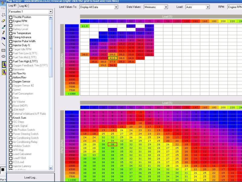

i was looking over some logs and im puzzled none of the closed loop stuff seem to follow the timing maps.... light cruise i will see some time 40-45* of timing... when my map says no more than 38*. and when i go wot it follows it exactly... idk... does the ecu advance timing in closed loop if it sees fit?
EGR advance map

ok will do, but i mean i kinda want it to subtract timing. because it just seems to keep ramping it up and then i get knock when the conditions change . i knock a drastic change will cause knock so it my ecu is raping up the timing now that i add a little more throttle the timing change is too agressive. like from 46* to 26* in less than 1k and 20 load.... i mean does that make sence?
