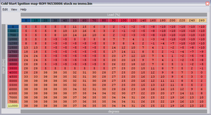

How drastic were the load changes in the 0-60 columns?
There's a cold start ignition map that could cause problems if there was a big shift in load scaling. I have only seen this map defined in the 96530006 ROM though.

This is the table I was talking about...
Attached Thumbnails Has rescaling your load caused the car to bog when the engine is cold?-cold-start.png
where is that located I don't have that one.
My rom is fully updated and has tephra V5
Bez found that a long time ago, I came across it on aktive matrix.
Originally Posted by 97TSiAWD
In newer EcuFlash versions (I believe 1.3 and newer), it is called the "Low Coolant Temp Timing Trim Map" and it's under the Timing section.
The map I posted has a different address than the "Low Coolant Temp Timing Trim Map"
