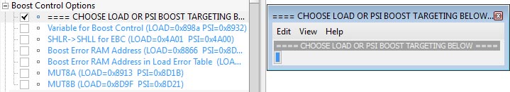

I downloaded number 4 of Phenem's modified Roms.
Since the default is now set to PSI based boost, how do I change back to load.?
This is what I see when I want to change over, doesn't seem right.
It seems there may be something missing there to make the switch over to Load?
Thx

Look at the table underneath that one and each table underneath that. They say in the description what the value should be if you want psi or load based....

concerning psi or load based boost control:
its my interpretation that you go to the blued area under single turbo boost, where it says CHOOSE LOAD OR PSI .....
At this point there may be a better way but I would work back from the thread where MRfred showed how to implement psi based boost control.... reverting back to the designations that that thread changed from. Except now you would look to change from the 96530006 xml even if that was not your original xml.
Because its from that thread that the current entries come from.
OOOPS, its right there, just change the values to suit!
concerning 1 byte and two byte load reading, thats a nike thing, just try the rom, I think your worries are groundless.

wow, you totally overlooked that section,lol. you don't just CHECK OFF that box, that is just a 'label'. All of the tables below that 'label' need to be changed. In the parenthesis it tells you the value you need to enter for load OR psi based boost control. If you want load, change all of theose tables to the LOAD settings.
