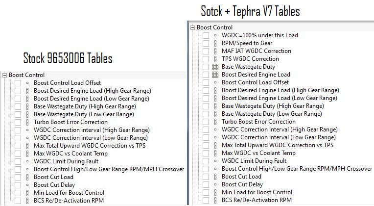

Somebody care to comment on what Boost control maps are still relevant and which are not?
I want to eliminate any unneeded/replaced tables where every possible.

  #131
tephra's Avatar
Joined: Feb 2007
Posts: 9,486
Likes: 67
From: Melbourne, Australia
BDEL High Gear Range
BDEL Low Gear Range
BWGDC High Gear Range
BWGDC Low Gear Range
Are no longer in use. The rest are.
