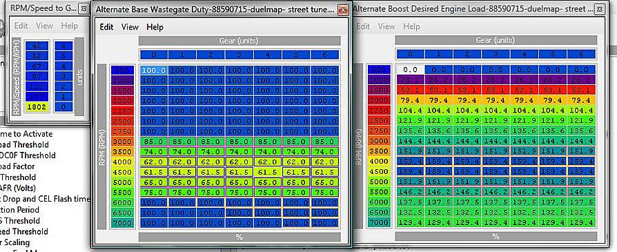

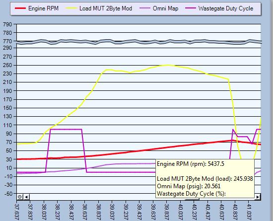

Recently converted to V7 with no major issues. I was on pump(main map) at the time. Everything worked just fine. Boost, drive ability, AFR's, etc. I then put in some E to test out the alt maps. Everything is great, except for the fact I'm boosting lower than pump. I just copy/pasted my original values of WGDC main/alt to V7. I can't get any higher than 20psi on E. On pump, I was hitting 23-24 with no problems. Here's some attachments to look at to see if I did anything dumb. If these aren't enough, let me know what you need for further diag.

Edit: Notice my WGDC drops to 0 after the "max DC to x load". I have that table set to 170 load, which coincides with my logs.
I installed the direct boost patch to my xml to see if I could get different results- no luck. Pics in next post.
Attached Thumbnails Boost problems-no-boost-alt-map.jpg   Boost problems-v7-load-boost-settings.jpg

Here are the creen shots of my rom with direct boost contol. I was hoping this would fix my issue and it didn't. Boost adder is 14.5 (current elevation). I don't get what I'm doing wrong. Gotta be something stupid... I hope

Edit: my boost hits 20 and stays flat....no matter what changes I make. Notice the WGDC hits 100 and cuts to 0. It's never done this before I switched to V7, which makes me think that I did something wrong.
I want to hit 29psi and taper to 24. I was able to do this before on 5.10 with just controlling duty cycle (no direct boost control, just load controlled). Now with load controlled or direct controlled, I can't get over 20 psi.
