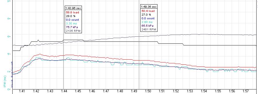

Here are my screenshots from page 4 of that thread:
OK, I think I have narrowed it down to 65-85 kpa/1800-2400RPM. Both of those have to be true for the issue to show itself.
Here are three areas of that log to illustrate what I mean. It may be hard to see with a lot of crap here, but the bottom half of the graphs are the area to look at. I have two markers for the RPM range, which are dotted red and blue horizontal lines. The IPW is a light blue, load is red, RPM is light purple, map is blue:
This is right after a shift, coming into the problem area. Even though I stay in the RPM range here, once the map drops below 65kpa, everything smooths out. Notice the jagged IPW in the trouble area.
The left side shows the trouble, the right side shows normal. Notice once I get over the RPM range, everything smooths out nicely.
This one shows a good example of a nice smooth IPW on the left side of the graph. Then, when I cruise through the trouble RPM zone at the right map, you can see the jagged IPW and even a couple areas of jagged RPM. It almost feels like very minute repeated fuel cuts.

Just quoting myself from the other thread to try to add pertinent data to this thread:
I appreciate the effort. Load is jittery as well, but again, not as much as the IPW. You can see the various screenshots that I have posted within the last few pages (starts on page 4).
The following are 'jittery' during the issue:
-load (I am just logging tephra's 1byte load right now)
-map
-Hz
-RPM (sometimes...this is what I can feel and I think is an effect of the IPW)
-IPW (seems to occur in the 2ms-4.5ms area)
It seems to happens only between 65-85 kpa and 1800-2400 RPM. Both have to be true for the problem to arise. Once outside either of those ranges, the IPW smooths out and no hesitation can be felt.
Of all of those, IPW has the biggest jumps, maybe a change of up to 80% (in some cases it appears to be a rapid drop down...say from 3.6ms to 1.99ms). The rest are miniscule in comparison. The curve that seems to follow the jittery IPW the closest is Hz, if zoomed in sufficiently for proper resolution. but, this is maybe a 10Hz swing in the 125-225 Hz range, so in the 5% range.

Quoting another post with logs that mrfred wanted me to do:
OK, here we go...here are some screenshots, followed by the two logs (way to the gym and way home). I have a lot of other things logged, but with DMA, it doesn't matter...just hide those.
This shows the jagged IPW, with the other curves labeled....IPW smooths out once past the 2500 RPM mark:
This shows another area while cruising in the trouble zone:
This shows cruising outside of the trouble zone (map too low), with a smoother IPW:
This shows idle with a nice flat IPW:
Ah crap...the .dif files are too big. Zipped up, they are about 150kb, too big to post. Let me know if you want me to email them to you.

Another post of mine:
Here is a screenshot from the MAF log, showing a cruise right through the issue area while using the SD ROM:
Note the IPW is very smooth and tight. It only varies by one loggable step, rather than jumping between 2-4ms like with SD. This is the same exact range where the problem exists with SD.
