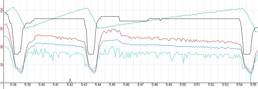

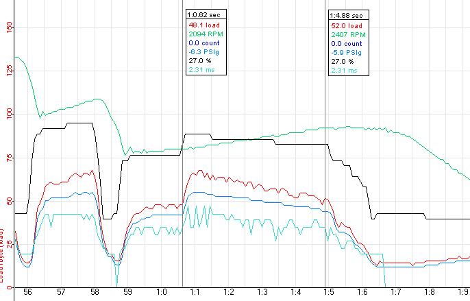

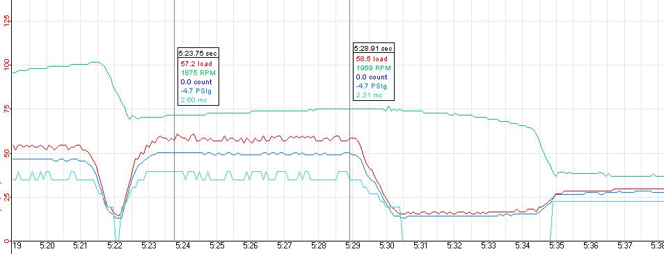

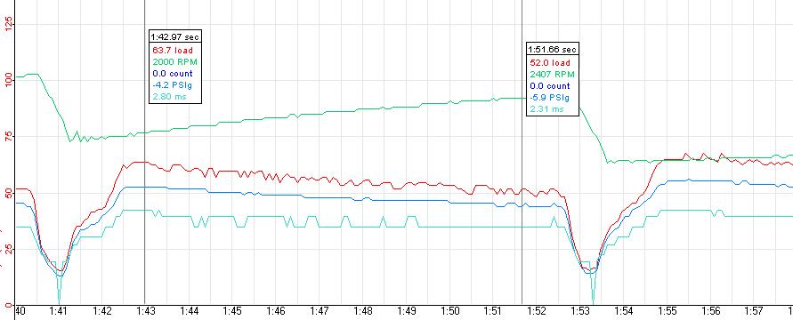

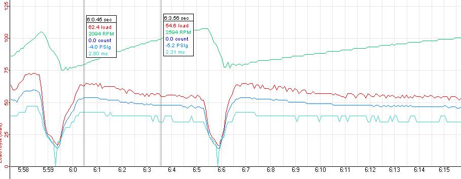

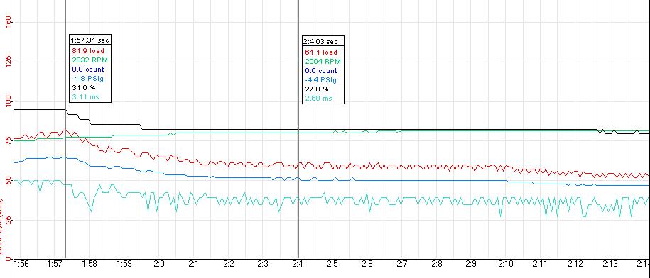

OK, here are some logs showing the IPW issue, with the stock 0x162c value. A couple notes: this is running E-85 on 1250s. As I thought, the amplitude of the IPW jitter is a bit smaller than with my stock injectors, but the logs still clearly show the issue as well as I could slightly feel it.

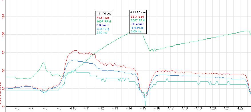

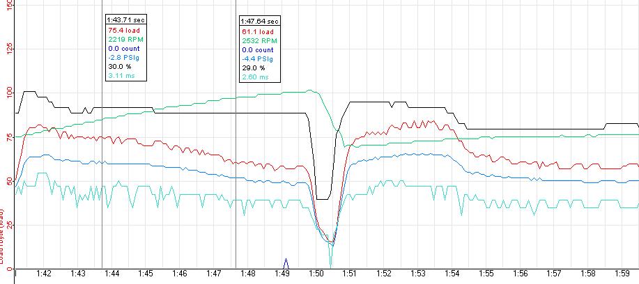

Here are the results with changing 0x162c to 255:
This seems to have worked!!!
The above are the absolute worst I saw in the log. The whole log was just way smoother. No jerking or hesitation. You can see the jitter is gone and just the normal 1 step in IPW here and there.

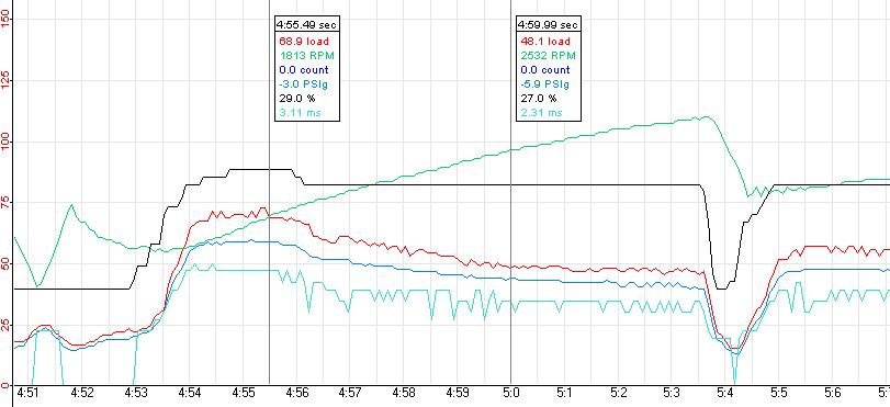

Here are the results with 0x162c set to 0:
You can see that the jitter is back. I could feel the jerkiness in the car as well.
