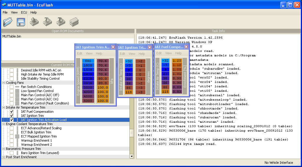

Here are the stock tables that are already in use.
The IAT Fuel trim is a multiplier. It accounts directly for density changes. If you wanted to change the AFR with respect to IATs, you'd change the multiplier by the percentage you want to change the AFR.
So say at 56C, you wanted AFR to richen 5% above the AFR at 25C, the new value would be 0.945.
Notice at very high IATs, they pour on the fuel.
As can be seen, the stock ECU pulls out timing any time you get too far from standard IATs. For the reason I mentioned above, I would bet.

Looks like I need to update my xml.
