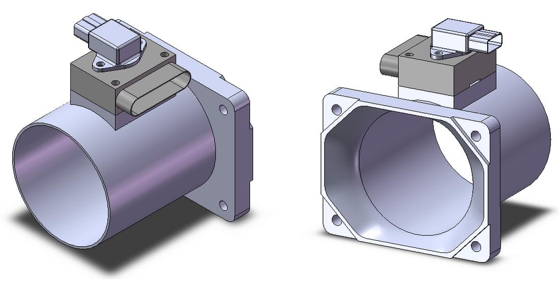

Yeah, plastic molding is very inexpensive when the volume is up there. The number of people using this probably won't offset the expense of just the molds without it being pretty pricey.
I'm sure not what you are after, but for a true "Plug and Play" setup...toss the IAT in the inlet preturbo...
I know not Ideal, but I know the Suby guys do it all the time and it works fine.
Not a single wire to run or bung to weld in...
No new intake or filter required to get rid of the MAF
Works with stock inlet box.

Originally Posted by SpoolinUp
Mitsubishi Connector does not make the Male plug...looked EVERYWHERE. A whole boatload of Mitsu uses the Female plug though.
Maybe Tom and Dave would be willing to sell them individually? http://www.dsmlink.com/wiki/announce..._maf_connector
Edit: yeah, as Matt pointed out, that's the 2g plug. Not going to work for Evo MAFs.
This is not for the correct MAF....may want to remove the links guys so people don't go buying a bunk part.
That is for a 2G DSM MAF.
Thanks for all the input guys.
I searched and searched for the factory male connector. It didn't exist so I decided to "make" my own. I am for sure going to make a run of them but there are a TON of steps involved to get it all right so we will see how many and how much it will be. As Fred said, still developing it all.
Really good idea. The baro I found is very close to the factor scale, within under .03 bar throughout the scale looks about right. The sensor I found would work without a rescale and cost about $30.
Most of us have the stocker kicking around. Plus they are common on most DSM era cars too, so yeah there are about a billion of them. This may be the best solution.
What do you all think?
Id be interested in buying a bunch as well.. We sell several Sd kits a week and this would be a nice edition.. Thanks!!

For those wanting to use the factory 1 bar MAP sensor, there are couple of potential drawbacks.
1 - It does not have quite the same range as the factory baro sensor. A scaling table or conversion formula in the ROM might be needed for it to integrate properly.
2 - I don't know much about the price of plugs, but I wonder if the cost of a MAP sensor plug is on par with the $30 baro sensor.
1 - The minimum reading in the stock MAP sensor is about 250 feet MSL or 29.53 altimeter setting. I think that is on the border of just fine and not. On the other sensor it goes lower than -3000 below sea level and well below the lowest barometric pressure ever recorded. I still think the other sensor is better suited but we will give it a shot on both sensors. At least mrfred will. I'm good at executing but so far behind on the software.
2 - I'm about an expert on plugs by now. I have had samples on the way since 3 hours ago for the stock MAP sensor connector.
I'll get you one of each mrfred and we'll work from there.
