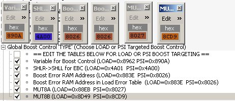

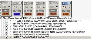

Step 1)
Set all the psi based boost control variables from the load to the PSI equivalent
Step 2)

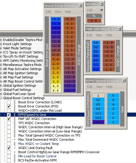

Set the boost error correction table scaling to the 5 bar setting by right clicking the map and changing the scaling with the drop down if you are using v7 like I am.
Not seen here is the WDC correction interval is set to 3 for my 3 port.
The reason the first entry in the boost error correction is 0 is not to get the ECU to add WDC when the turbo is still spooling up.

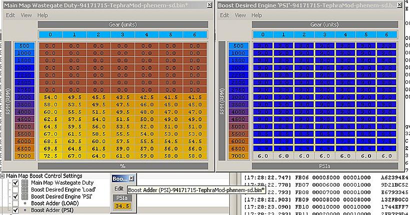

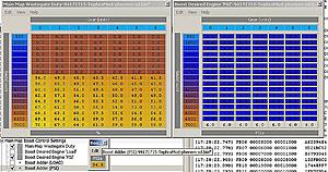

Step 3)
Set boost control settings by first changing out the scaling on both the boost adder and desired boost to the 5 bar scaling. The boost adder uses the psia16 scaling and the desired boost uses psia8 scaling which stand for 16 and 8 bit respectively.
Note that this is a PSIa setting meaning you need to add 14.5psi in order to reach just 0psi. I set my Boost adder to 34.5psia to achieve a base boost setting of 21psi.
Next I add 10psi to the boost table and taper it down to 7 in order to achieve 31-30psi of boost tapering down to 28psi by redline. You can set you own settings anyway you want.
Step 4)
Test!
I personally suggest using a test boost case with a good known wastegate duty settings and lower than the boost is desired to see if your boost error table will reduce the boost as needed.

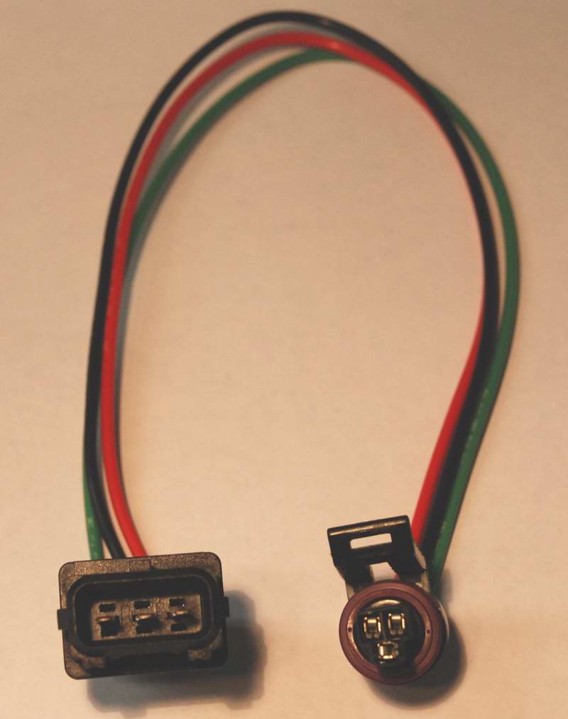

What about the wiring?
Oh and THANKS.
Oh and THANKS.
I have not played with ECU based boost control much with v7. Might just have to give this a shot.
Good point
I used the mdp adapter which looks like this.
And I contacted zeitronix to make me an adapter to just hook into the wiring for the mdp. You could if you wanted just solder the connection on but i like the idea of being able to go back :P
