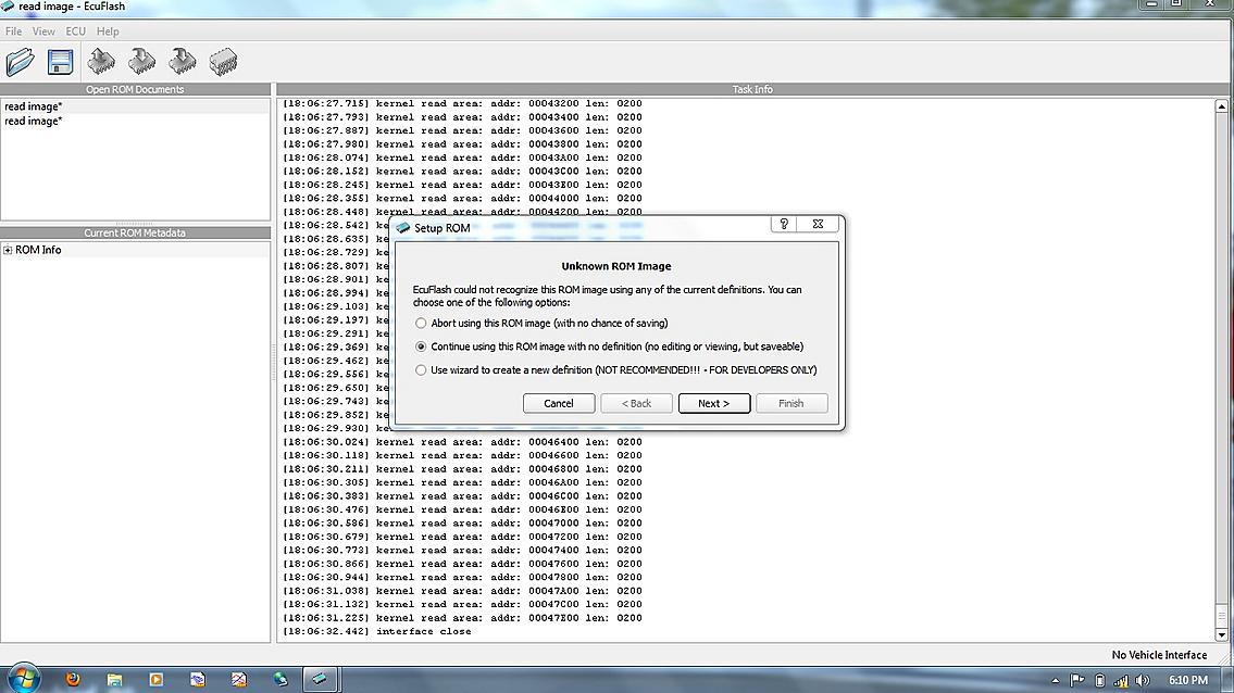

Has Any one received this message when trying to reading a ROM for the first time.. It's a 2006 Evo IX
Advice is appreciated.

You know at the very least you'll have to press continue viewing with no definition so you can find out what rom ID you have. Then if possible search for the right xml for that ID.

Mike, is this a ROM from your car's old OEM ECU? Was it ever tuned by someone else? There's a few "tuners" who think obscuring the ROM ID is good copy protection for their work; you probably just need to change it to the correct value. (Shoot me an email, I can probably fix it up for you if you want.)

If I hit continue it doesn't display any Info at all.
Ed, I will shoot you an email. Thanks
-Its a friends ECU not mine.

Click through the appropriate menus and the rom should come up as undefined. If you can't find information about the romid on here or the ECU tuning wiki then attempt to change it to the common evo IX map ID.
If you do the latter, I recommend copying pertinent information to your tune, and not flashing the whole ROM that you pulled.
