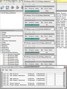

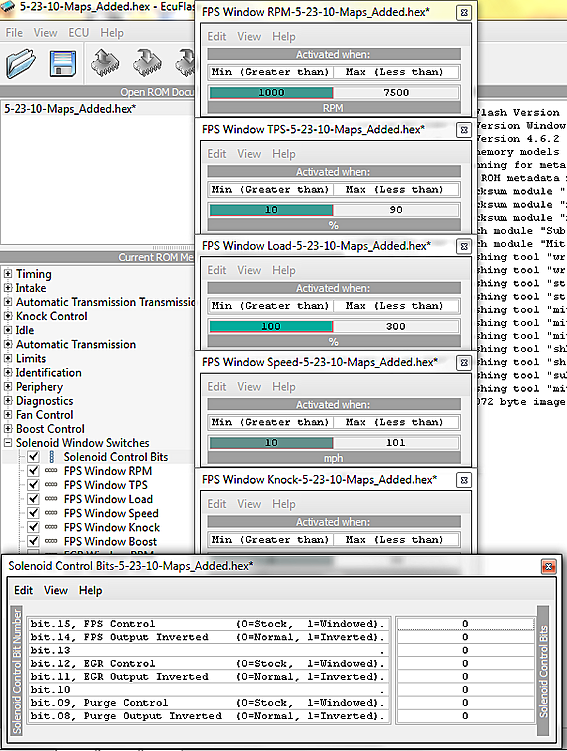

This is how I did Solenoid Window Switches for my DSM Flash Mods. Think it is an easier approach then using tables.
EcuFlash doesn't offer a table with multiple scalings, so unfortunately I have to use six tables.
There are six windows for RPM, TPS, Load, Speed, Knock, and Boost. You must be in the window for all six, for activation.
Stock or Windowed Control is by a flag byte, that allows Inversion of output also.
