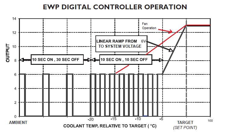

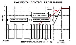

This is the two exact issues I'm working on resolving for my car, although I want something very different then "always on" for the water pump. I would prefer to mimic the operation of something like this electric pump controller:
http://www.daviescraig.com.au/Contro...0-details.aspx
The main benefit though is that the pump isn't running constantly. It only runs when the engine needs it which will reduce the electrical load on the battery and prevents excessive cooling. When it's well below the desired temp, it pulses the pump every 30 seconds to keep coolant circulated to avoid hot spots. The closer it gets to the set point, the more it circulates the water.
My intention is to use the stock main fan PWM output and module to control the aftermarket cooling fan and then use the A/C fan output to control a second PWM module to control the water pump.
FWIW, that controller will also control the fan if you want it to.
