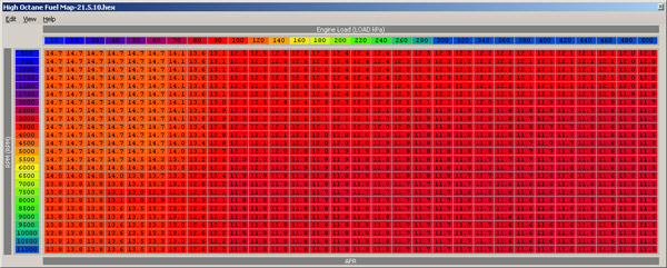

your injector scaling is most likely wrong. the fuel map should never be all 11's. you need to scale the injectors and then focus on the fuel trims to make sure they are good. the maf will need to be scaled also or it will throw off load and certainly closed loop idling.

Logged 1byte load in the same log, so just to get it right: ~100kPa was wrong (sorry my mistake) its 60-70kPa!
Fueltrims are good, they are in the 5% range (so actually right now -5% low trim, -2% percent medium trim... and high trim is something that NT engine is not able to see at all )
