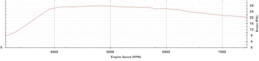

I'm still slightly confused by the BEC tables for PSI based control. What should the values be? My default values were all 14.5? seems strange.
Can anyone post some more examples of there boost control tables?

Yeah, it was strange....
OK read carefully please as I don't want to confuse you lol
...cause here is the deal, I spend like 3 hours today dialing in my WGDC table to get this curve. 28psi max without direct boost control (my correction in my logs is 0, all 100% WGDC)
This is a 3rd gear pull btw, 4th gear holds more boost up top.
Than I came across this thread and looking at the two previous posts about the tables I was like WTF? my BEC is all 14.5... so I started to change some tables and this is what I currently have, not uploaded yet..... basically used some of the values from the other posted tables. My boost adder is basically 14.7+10= 24.7, and than my PSI table is setup to run 28psi. My WGDC table should be very very close I would think as I spent a while on it today.
Let me know what you think.... am I on the right track here?

Joe, I would set your low-rpm BDE tables to the max boost you want to run. Otherwise if your turbo spools faster than what you have there, it'll start dropping WGDC, which you obviously don't want during spoolup.
Also, on my car I set max upward correction to 0 across the board to keep from seeing small boost spikes as the turbo finishes spooling and you're just under your target.
My 2¢!
My 2¢!
Cool man, thanks for your input.... my BDE was set from logs of my pulls ... basically matches my spool almost, the table is slightly higher than my spool.. but your advice wouldn't hurt. Thanks for the input.
