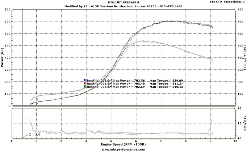

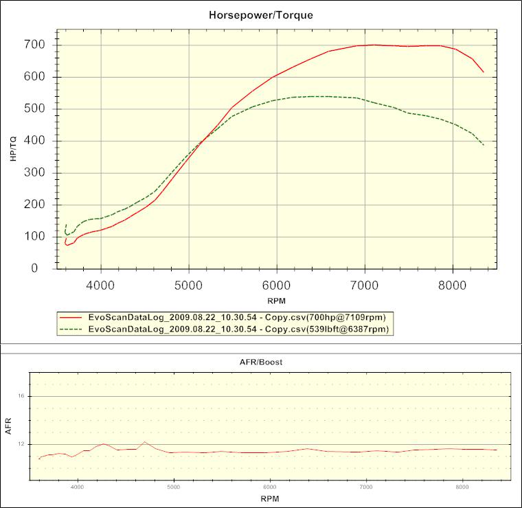

Mellon Tuning EVO 8 5-speed GSR on my 245/40/18 tires
BR HTA86 @ 38psi on e85
Buschur 2.0L
Buschur Stage 3 head
Buschur BF272 cams (Might go to Kelford 280/274 cams for better idle with ac)
Buschur twin walbro fuel pumps
Buschur 3" tbe, test pipe, bullet muffler
Buschur 3" intake pipe + Mas adapter
Buschur UICP and LICP
Buschur Mini Battery
Buschur Race FMIC
Buschur COP
Buschur Fuel Rail
ARP head studs
PPI ported stock intake manifold
PPI 65MM throttle body
FIC 1650cc injectors (going to FIC 2150cc high impedence injectors for better idle/cruise)
Tilton Twin Disc Carbon clutch
Tuned by Mellon www.mellontuning.com
VS. MKC Dynojet

Mellon, your graph seems to be off about 150whp at 9k rpm. Has the tune changed up top since the dyno or is that just anomalies? I ask because if his stand-alone is right, you might be getting some valve float.

the Virtual Dyno graph is from an evoscan log done on the street a few hours before getting on the dynojet. I believe the dive on the end is because Virtual Dyno didn't clip the end of the run for me and I didn't cut it out of the log file.

I just deleted the old picture and updated it with one where I clipped the rpm off a little so the dive isn't there

It still seems to be creating anomalies at the end of the run. At least it's not valve float, that was my biggest concern at the power levels your beast is pushing out!
