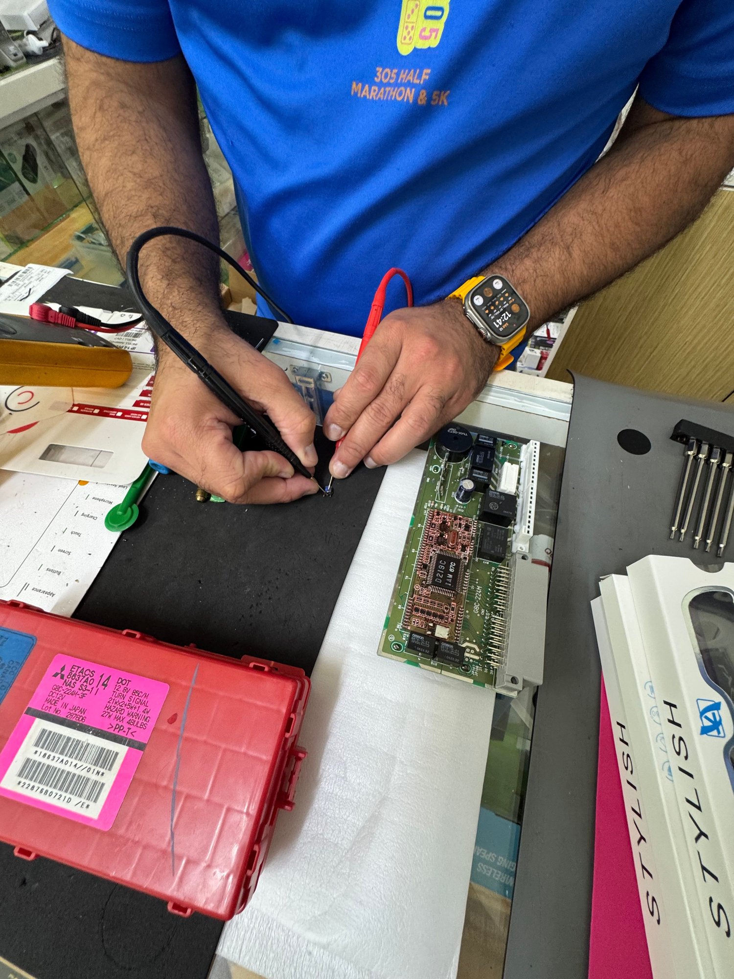

Micro Soldering PCB Fix
10+ years later im somewhat in the same rabbit hole as most of you were. I lost the 1 key that was registered to the immobilizer. I decided to call an auto locksmith to have a new key made a programmed. The locksmith pulled out 4-5 computers trying different setting etc at one point the computers stopped registering car. Had to go to the dealership. The were able to program a key but were not able to reprogram the remote / fob for the central locking. Ive tried every which way to reprogram I even purchased different remotes and batteries to knock out all possible variables.
With some late night digging and self diagnosing I realized my "Auto-Dome" light does not turn on when door is open and now my fob does not program so the only option would be there's something wrong with the ETACS. Im under the impression the ETACS was RESET at the dealer at the time the new keys were registered so if they weren't able to program remotes via software than it must be a hardware issue.
I removed my ETAC today (unplugged the battery) and took it to a local electronics repair shop were the attendant is proficient at micro soldering and fixing PCB boards. Being that the car is 20 years old parts are not as easy to source anymore and the likeliness of ordering an ETACS on eBay and it be friend also are 50/50 not to mention it might need to be reprogrammed to my vin? (didn't find conclusive statements on this). In short I took the ETACS to him to check for electrical continuity on the board ie. resistors mosfets, ect. Came to ONE possible conclusion that one of the MOSFET chips is bad to which we removed the chip and checked additional continuity to isolate. From his and mine understanding the chip was not grounding properly. So we ordered a new MOSFET chip and are awaiting for arrival to solder and hopefully fix what we think is the issue.
Additionally ive gone as far as ordering a used ETAC on eBay. They are now sub $100. With the hopes of having a secondary option with the dealership being able to reprogram the ETACs and install.
