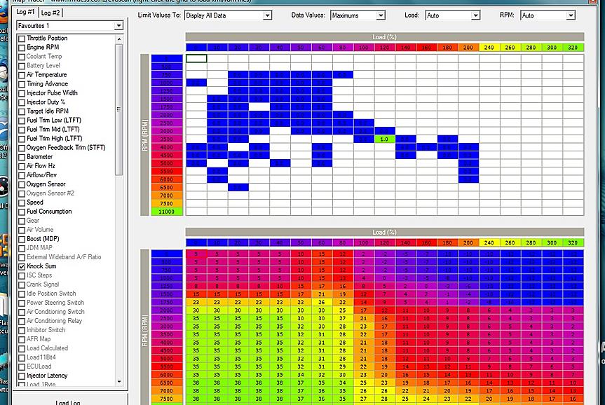

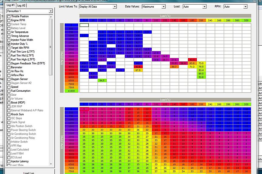

Hello Everyone,
Since you took this ride with me I thought I should give you an update.
My first mistake was logging ecuload so I was only seeing load to 159.
Amazing I didn't blow my motor not seeing what was going on in higher loads.
I changed to load mut 2 byte and now I see the higher load ranges.
Now here is the latest results.
Any complaints? worries? tips?
Thanks for all your help and advice.

Looks ok if you are hitting 300-280 load but your maptrace shows only 200 or so which would put you in the too much timing under wot boat..But given the title of the thread mabye that is what you are going for here..

Map tracing is not the way to go either. I mean you can do that, but i do not like map tracing. I learned to read the raw log and edit based on that. Map tracing can get you into trouble if you're not paying close attention to what you're doing.
