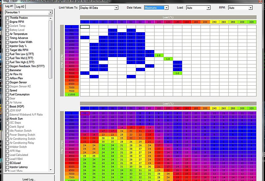

Low rpm timing is WAY too high. Timing out the top should be 17-18*, 19* max.
Something like this-
This is an Evo8 with a 57 trim, 28psi, MAF, stock cams, made 474whp. Most of the run was 320 tapering to 280 out the top for reference.

Originally Posted by Guru Johnson
Hello everyone,
Yeah, I started pulling timing and that fixed it.
Amazing how the 93 oct timing is actually higher than my E85 timing
yet the E85 is still blasting out way more power and torque than 93 on lower timing!
Anyway, Here is where it's at right now.
Gonna go out on a limb here but can i see the data log from that pull?
