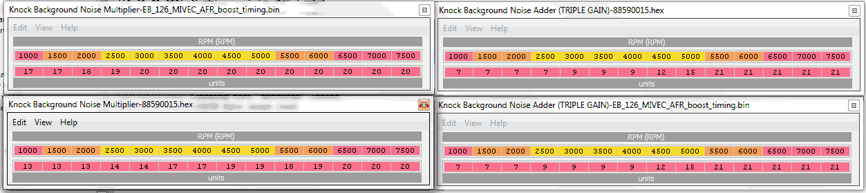

Here are my knock tables for my 2.0 built motor. Modified are above, stock below, for quick comparison.
