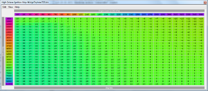

Anyway first start yesterday and i noticed that even when the motor is free revving it was spiking knock counts up to 20+
I have made the knock sensor tables less sensitive to get around it while im running it in for the next 1000kms, but is this normal?
Ive got the car running in on my 2.0ltr timing maps which are pretty weak anyway, its below.

stroker normally run lesstiming than a 2litre, but because you've changed the internals the stock frequencies wont be any good so you'll have to do some messing with the knock tables to get it right, I recommned making a set of det cans

As you can see the timing map is pretty weak so i thought it would be ok for a 2.3ltr its actually similar numbers to another members timing map too i noticed with his 2.3ltr
I dont need to make det-cans ive got some at the shop just havent had time to listen to it yet

That timing map is very conservative. Try adding more timing?
whats your AFR's?
Also use det cans to verify the knock/det.
