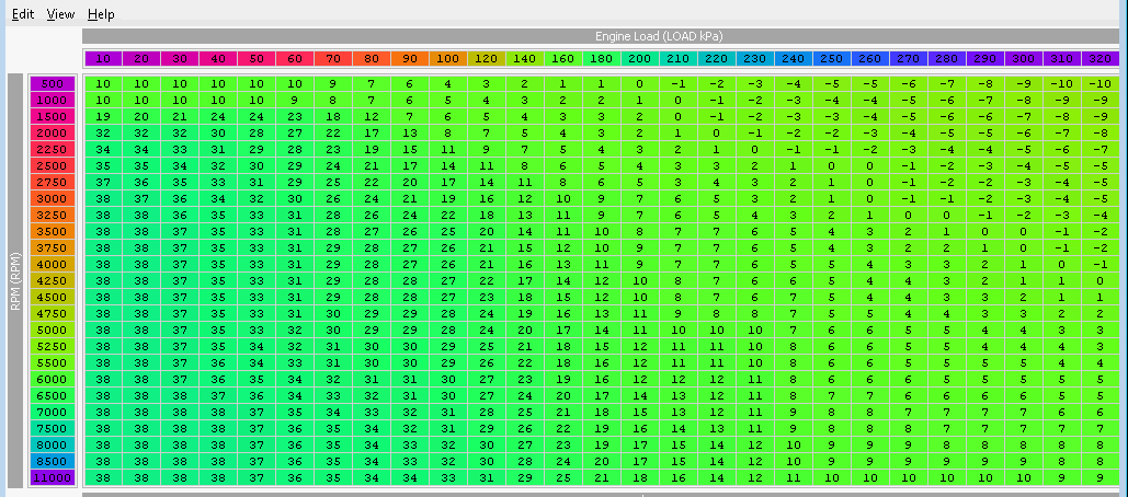

Do you think this timing map is too aggressive?
Im only hitting and holding 305load @ 4000rpm to redline
Im listening with Det Cans and cant hear any Det
2.3ltr GT3037S S2 Cams
Im asking because sometimes its hard to hear Det over Screamer pipe, i usually put the windows up and listen to it WOT cant hear any, just wanted others thoughts

Timing looks ok. Do yourself a favor, download software called 'CamStudio' and run a cable from the headphone port on the det can module to your laptops mic input. The software allows you to capture video screenshots of your laptop while also recording the audio. It's used for people who make online tutorials on how to do stuff on the PC.
