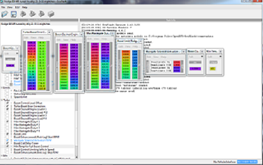

Boost tuning for 1.5-1.6 bar
Originally Posted by Kings Fan
Did you mean to say you put boost limit is 320? 230 is too low. You should lower your WGDC if you're over boosting. Post your boost maps, It doesn't look like its correctly tuned at all.
Boost control load offset:100
Boost desired engine load:159.4 till 4000 then down
Max wastegate duty cycle: a U curve with 69 in the 3000-3500rpm range
Boost Limit:260 till 5500 then down
Sorry but i can't attach files dunno why???
Thanks for your help

Boost maps paint
Paint pic of the boost parameters

Turn down WGDC all to 0. Then see what your boost does. If your boost doesn't change there could be something wrong with the solenoid or install. Also that pic is too small to see anything.

It's ok man, it works very well, it's been a leak problem...
