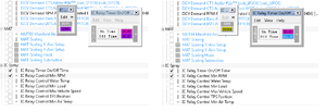

Ok heres a pic of what im taking about,
you will notice if i change the IC Off Timer the Min RPM changes also.
i just want to make sure this part is defined correctly before i change the settings and flash it to my car.
I mean it doesnt really matter i want the off timer to be 0.5 seconds which changes the Min RPM to 156, thats fine because it wont spray until min load anyway,
I just dont want to be changing this settings and its not actually IC Spray settings

ur xml defination is wrong, i dont have my laptop otherwise i would have give u the correct address....... i am sure someone else can help u

is that what u have
Code:
<table name="IC Relay Timer On/Off Time" category="IC Spray" address="247e" type="2D" scaling="TimeSec">
		<table name="Condition" type="Static Y Axis" elements="2">
			<data>On Time</data>
			<data>Off Time</data>
		</table>
	</table>
	<table name="IC Relay Control Min RPM" category="IC Spray" address="2480" type="1D" scaling="RPMStatLimit"/>
hmm try delete all xml definations under ecuflash..... then just add the two from V7 thread.... maybe u got an issue somewhere.

no i would go one step further and completly remove ecuflash (or all the definations) could be that u have a problem. i have had issues before when two files will have the same romID and it picks one of them and that usually is the wrong one. so easiest to backup all first then remove and reinstall. and then copy the files..... could be. i am sure when i was using 9653 i fiddled with the IC tables and didnt find anything strange. and the fact that u have different address in the XML but still changing one changes the other tells me u have a xml mix up.

try this address 0x248a for ON/OFF timer
Old Mar 31, 2011 | 03:30 AM
widge's Avatar
Joined: Mar 2010
Posts: 478
From: Australia
Ok as soon as i changed that in the definition the timing went from 11.2s off 0 on to 2s on 5s off so much more realistic numbers by default
And now i can change the values for start RPM and it doesnt change the on/off timer
Thanks heaps zaid, just making sure it is the correct address?
