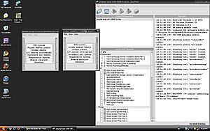

Ok, I have this little problem. I open up the window for OBDII Inspection pass/fail screens and I get this. I know it has something to do with the window size but I don't know how to change the settings for it. Anyone have any ideas?

While this wouldn't necessarily solve the problem, Ecuflash 1.43 adds a scrollbar when the table you're looking at is too big for the size of the window, you might want to try that.

Whenever I apply the patch for 1.43, it crashes... 1.42 is the only version that works.
Edit: NVM. I found out about the blobbits.

You should have a scrollbar to be able to see the full window.

Originally Posted by nudge120
What's the fix? I had this when I tried adding it on 90550001.
I applied this:
<scaling name="blobbits" storagetype="bloblist" storagebits="1">
<data name="0" value="00"/>
<data name="1" value="01"/>
</scaling>
To the evo7base.xml file. Since you have a VI TME though, yours would be different. Try putting this code in the evo5base.xml or whatever evo#base.xml your ROM uses. It fixed the problem I had.
