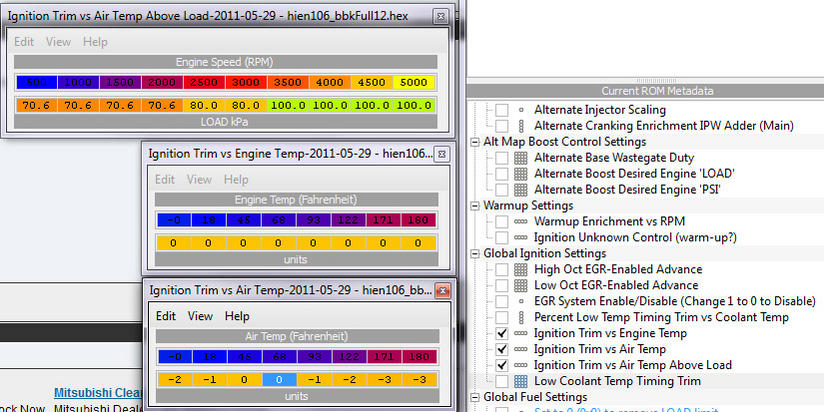

Thanks for pointing me somewhere. Is it common to modify those tables? I suspect on my rom, it's called "Ignition Trim vs Air Temp"?

So what I'm seeing is that it's better to tune in the cold (45-68 degrees ideally) and then the other temps will run safer because it auto-retards the tune?
Or...tune it in the hot weather and then overshoot my targets so that in 45-68 degree weather, it will be spot on? (which is what seems to be what I'm having to do)
What does the 'Air Temp' in this table refer to? Air intake temp (at manifold)?
Air intake temp at the MAF, where the sensor is located.
