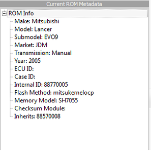

Cool, thank you. I went back to that thread and there was a xml file uploaded which I put into my evo rommetadata folder and I now have the 2005 JDM Evo 9 in the inherit list.
This is the info I get now, still haven't managed to open the tables.

Send me a PM and I will give you my email to send me the raw ROM and I'll try to help you out.
