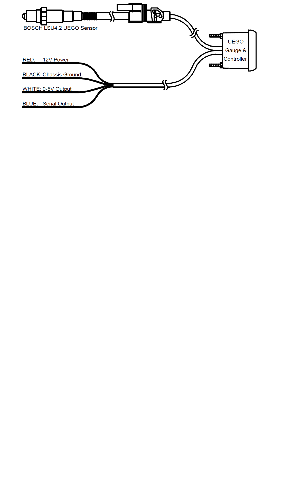

I think the AEM has a 0-1v signal to simulate the NB signal. A bit of searching should get you some more info, but basically you have a wire going from the real NB to the ECU. You're going to cut that wire close to the ECU and have the AEM's signal replace the one coming from the stock o2 sensor. In my case I decided to use an on-off-on switch so that I can choose to run either the stock o2 signal (when I go to the track or if my WB dies) or the simulated signal from the WB.

It has a 0-5v signal output
Can I rescale the ecu??

I know in my dsm i used my ugeo to narrow sim works perfectly fine. wired the with wire in to the ecu thru o2 pin. activated narrowband sim in ecmlink.
