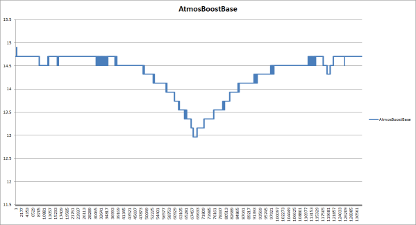

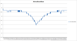

Here's a nice log graph pic... of Crimson Red testing out the Atmospheric Boost Baro Compensation patch for JDM ROM. He found a convenient mountain, and drove over it.
This logging item is the dynamic variable that RAX Patch feeds in to the boost target code... replacing the original "Atmospheric Boost" constant. PSI-based boost targets will therefore be the same "gauge" pressure at any altitude.
Nice pic!
