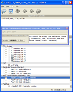

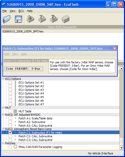

Okay, I've tried a number of different ways to present the Omni 4 Bar tweak. Here's the one I think is the go...
I've made the subroutine selection cycle through three choices, and added some help-text (which I didn't even know was possible until I found it by accident!):
It doesn't mess up the patch selection with a whole pile of Omni "extras". For people with stock MAP sensor, they won't be bothered by it...
Howzat?
Rich
PS. Anyone with Omni 4-Bar want to try it out? It looks pretty and all, but it's got to work properly too!
