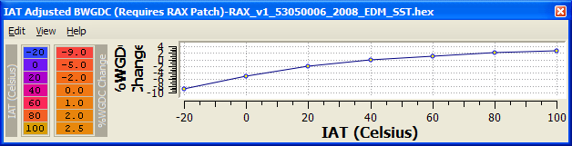

IAT Adjusted BWGDC
This patch makes it possible to adjust your Base Wastegate Duty Cycle in line with Intake Air Temperature.
A new table becomes available in the EcuFlash Turbo category:
The adjustment factor is applied directly to the relevant Reactive Solenoid Base WGDC Map lookup value, if that value is between 0% and 100%.
A Base Wastegate value of 0% will always remain 0%, irrespective of IAT.
A Base Wastegate value of 100% will always remain 100%.

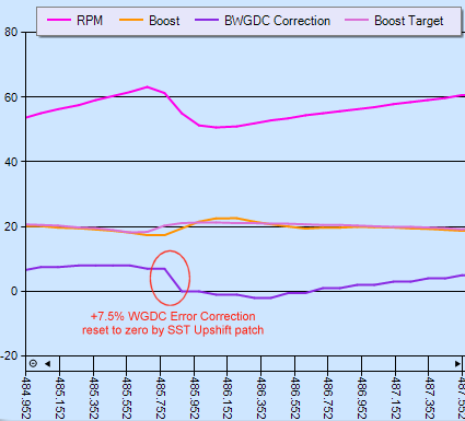

SST Upshift Boost EC Management (SST Models Only)
This patch may be useful for reducing boost levels during SST upshifts at wide-open throttle. It will zero out any positive error-correction factor when RPM is dropping.
This patch will do something meaningful if:
  • Reactive Solenoid Max Total Upward WGDC Correction vs. TPS table is set up to allow upward/positive error correction.
  • Base WGDC and Boost Target tables are set up in such a way as to require the use of upward error correction in order to meet boost targets.
With boost error correction configured to suit, this patch will result in a lower wastegate duty cycle being used when a wide-open throttle SST upshift occurs, eg.
While this patch is no "magic bullet" for high boost during SST upshifts, it can help reduce the severity of the problem. That is, if your SST behaves like this in the first place - some do, some don't.
