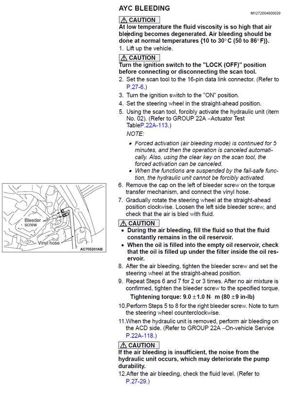

Who would be interested in paying for a little windows application that works with your OP20 cable.
This application will just do some of the things the MUTIII does, but without having a MUTIII
So far:
- Timing Chain Elongation query and reset
- AYC Bleed
- ACD Bleed
I hope to add (but it may take a while):
- DRL disable
- TPMS disable or at least relearn
- Reinstate ECU
Thoughts?
-edit-
AYC/ACD bleed are working RIGHT NOW...
I am having an issue with the timing chain report/reset, which I wanted to get done for the first release...
If people want the AYC/ACD part, send $25USD + paypal fee to my paypal (in my sig) I will send it to you, when the timing chain bit is done I will give you a free update
Cheers
D.
