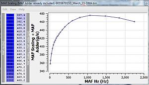

No, it's not clear why you are cutting. So I would suggest managing the problem, if you are hitting those loads it would be a good idea to extend and scale the MAF values. Here mine so you can see the idea.

Cool thanks. Ill try that out. Might be a stupid question but will this mess with my already tuned afrs?

Yes, likely you'll run a bit leaner at high RPM, check it out with your wideband.
