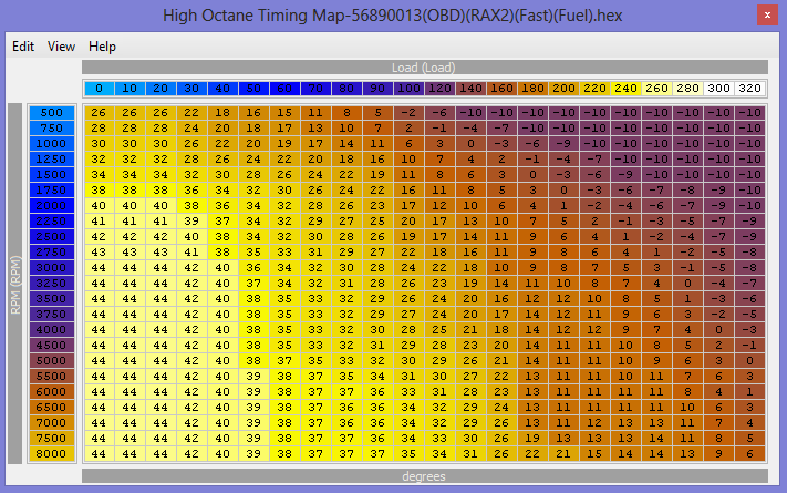

heres my current timing map. I still consider myself a noob to tuning so don't be too harsh. ill gladly take tips/suggestions.
You're running 13 degrees advance at 7000rpm/180load?
I'm running 20 degrees advance in that region...
Rich
Rich
work in progress lol. no one else posted much so I thought I might as well start
are you on 91 octane?
no, im on 93. what would you recommend I run up top?
EDIT: mods are uicp, perrin drop in, gs3port, walbro255lph, 3" test pipe, tomei expreme catback.
With 93 you can run 15-16* up top. Above that it will start knocking.
