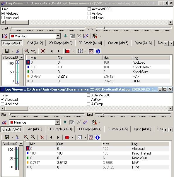

I think you have very low values for 94 octane. Starting from medium loads, at loads up to 100%. I have a simple 4b11 not turbo (Outlander XL) engine and 91 octane, look at my timing for max/medium loads. These are very good angles for me, see the log. AFR is of course important.

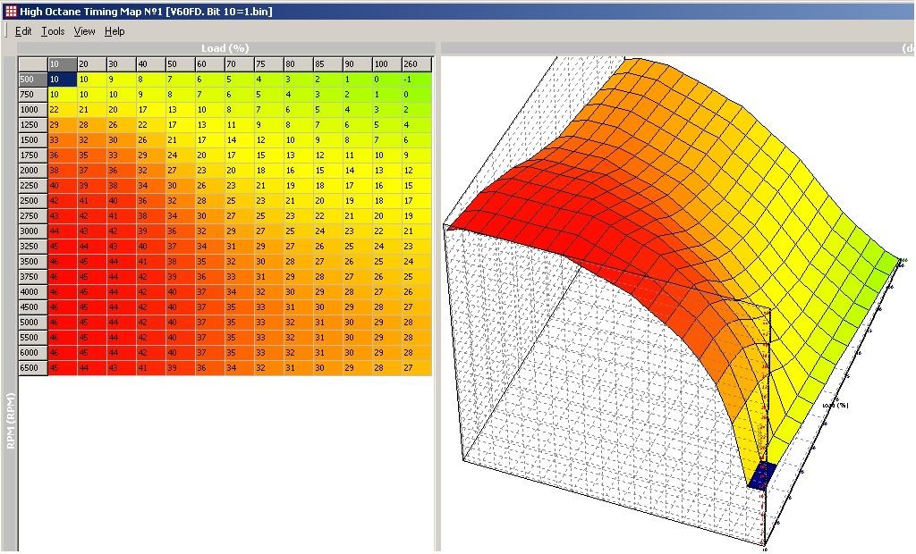

Try this for a start up.
File Type: xlsx
