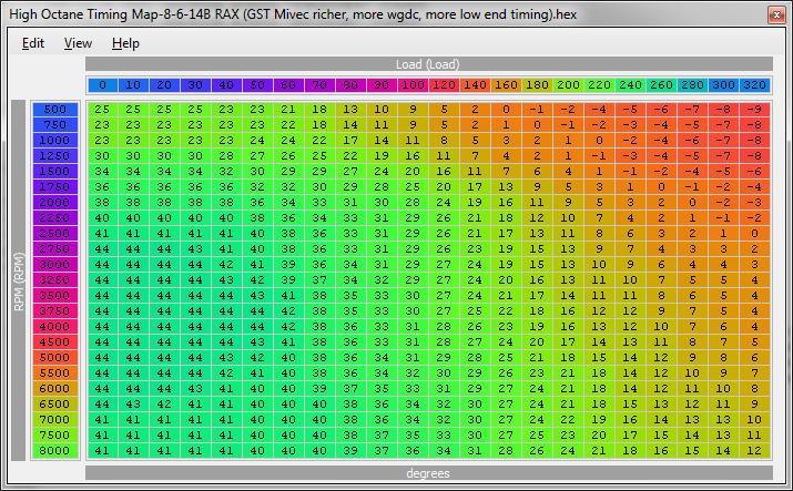

Old Aug 8, 2014 | 06:31 AM
  #51
honki24's Avatar
iTrader: (23)
Posts: 1,580
From: Houston, TX
Wow this thread is dead! I just thought I'd look for a X timing thread like we had for the 8s because I'm starting to get away with very high timing on my X. I'm on 93 with intake/exhaust/tubular manifold/FMIC/cams, stock turbo. Running 25psi I hit 250ish load at about 3000RPM and don't go below 220 load at 7500RPM. I've noticed that with lots of overlap in MIVEC and my S1 cams I can (and need to) have lots of timing. My spool area (2K-3K, 80-120 load) has very high timing compared to what I'm seeing here. Knock counts are the occasional 1-2. AFR are between 11.5 and 12.
Attached Thumbnails Lets see your Fully Tuned Timing Maps..Evo X Style !!-flatlinetiming.png
Old Aug 11, 2014 | 10:17 PM
  #52
chetrickerman's Avatar
Veteran: Army
Joined: Dec 2008
Posts: 575
From: Colorado Springs
Your car must make a butt load of torque with that kind of timing

Looks like the large overlap is changing your dynamic compression enough that cylinder pressures are lower which allow more timing.

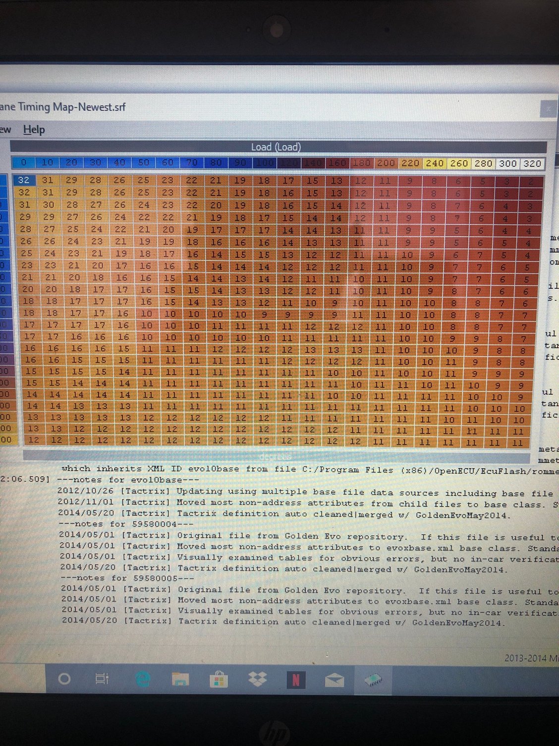

Old Sep 23, 2020 | 06:00 PM
  #60
Boeckxy's Avatar
Joined: Sep 2020
Posts: 2
From: Kamloops
Resurrecting this post to see if I can get some help! Took Evans performance Evo X tuning course and have been starting to tune my fully built Evo X. Was looking for some input for tuning the timing maps and wanted to see what you guys think of my current map setup for starting to do my first WOT pulls. Fully built bottom end, 6262 stock frame comp turbo, GSC S2 Cams+springs, open dump downpipe, ID1000's, 3.5 intercooler FBO Etc. 94 octane.
please be easy on me I'm very new and this is my first attempt at tuning! Idle, acceleration and drivability is dialed in. Just having some issues with tuning out knock/fueling at WOT.
