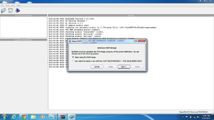

hi guys i just bought a new laptop cause my old one was stolen and i lost all my logs and ecuflash files...now i downloaded ecuflash version 1.43.3252 and it connect to the car and and reads it but then a message appears..."ECUflash could not recognize any of the current definations"...what is wrong here?

You don't have the correct definition file for your ROM. If you know your ROM ID you just need to find the definition file and put it in your rommetadata EVO folder.
For example if your ROM is 88770005 you will need the XML file titled 88770005.

Were you running a tephra rom? If so you'll need to re-download the xml (as stated above).
