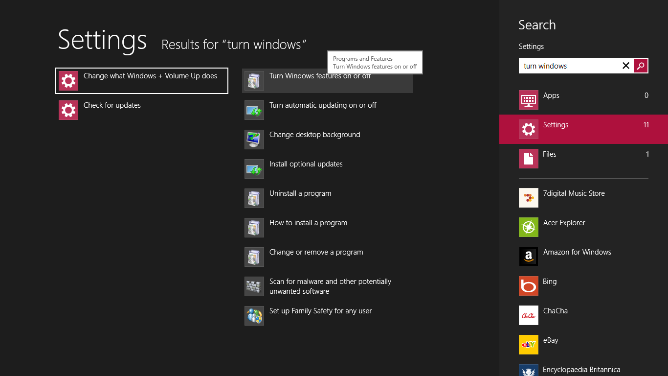

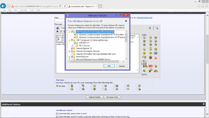

go to the charms bar and click search. start typing "turn windows.." into the search bar. click Setting (under the search bar), then click "turn windows features on or off"(attached pic below). once that screen loads, click the drop down (little plus sign) for .NET framework 4.5 Advanced series and also the drop down for .NET Framework 3.5. THEN make the selections to match the ones in the attached image. once you do that, uninstall your current version of ecuflash, go into program files and delete the whole OpenECU folder. then go and download the EcuFlash BETA and install that and give it a go. let me know how it goes.
This makes the drivers work on Win8 on my computer.
go to the charms bar and click search. start typing "turn windows.." into the search bar. click Setting (under the search bar), then click "turn windows features on or off"(attached pic below). once that screen loads, click the drop down (little plus sign) for .NET framework 4.5 Advanced series and also the drop down for .NET Framework 3.5. THEN make the selections to match the ones in the attached image. once you do that, uninstall your current version of ecuflash, go into program files and delete the whole OpenECU folder. then go and the EcuFlash BETA and install that and give it a go. let me know how it goes.
A quicker way to do this is when you open the charms bar click on Control Panel->Programs->Turn Windows Features on or off
Note that adjusting the .Net installation options is only necessary since one of the flashing/logging programs (don't remember which) needs .Net 2.0 which is only installed with .net 3.5 and thus is not installed with Win 8 out of the box. That would stop the program from working but not prevent the drivers from working. If anything these steps most likely work because of the last step where ECUflash is uninstalled/re-installed
