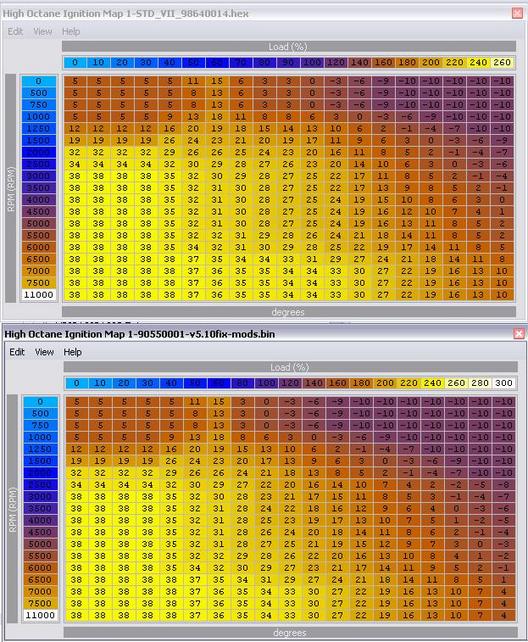

do you have more info on rescaling of the load axis?

Turbocharged, then your engine will exceed 100% load, what type of turbo & what boost level?
Rescaling load is done by simply inserting different values, it's usually done to accommodate higher than stock boost levels and turbo upgrades, it could used the other way around, decreasing max load & giving you more resolution in both ignition & fuel.
It's still the same process, data logging should provide you with the load vs rpm coordinate to build both ignition & fuel maps.
The image is of a stock ignition table vs rescaled load table
