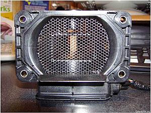

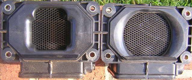

The Lancer MAF (mass air flow) sensor is a very restrictive piece that bottlenecks the engine's ability to breathe. By swapping in the MAF sensor from any number of other Mitsubishi vehicles, you can remove the restriction and gain some HP in the process. The following MAF sensors can be swapped into the 4G94 Lancer:
- 501 -

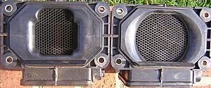

Stock Lancer MAF shown on the left, larger 501 MAF shown on the right:
Typically found in Mitsubishi vehicles with a 4G64 engine:
ECLIPSE 00-02 (All trims)
ECLIPSE 03-05 exc. GTS
GALANT 99-03
MONTERO SPORT 99-03 3.0L (6 cyl)
OUTLANDER 03
SEBRING 01-05 (Coupe)
STRATUS 01-05 (Coupe)
This MAF is the most practical swap for a non-turbo Lancer, as the MAF values from the 4G64 ECU are easily adapted to the Lancer's ECU with EcuFlash. This MAF is only rated by Mitsu for 210 liters/second, and has ~.78 psi pressure drop because of the larger airhorn blocking the inlet.

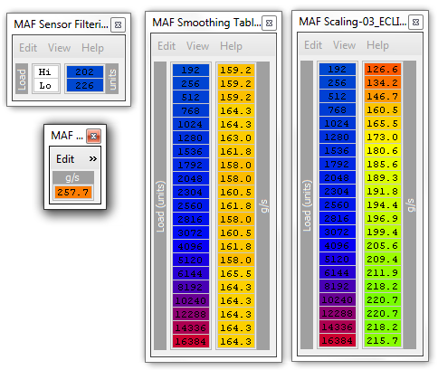

-1- Using a Tactrix/OpenPort cable, read your ROM from your ECU in EcuFlash.
-2- After EcuFlash finishes reading your ROM, expand the Fuel category in the left pane to reveal the MAF tables.
The tables you need to modify are: MAF Scaling, MAF Smoothing Table, MAF Sensor Filtering and MAF Size:

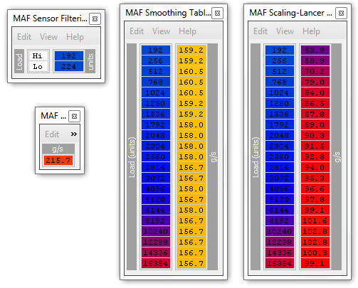

Here is what the stock Lancer MAF values look like:
-3- Using the values for a 2003 Eclipse GS shown here, change your Lancer MAF values to the larger values for the 501 MAF:
-4- After you have changed the MAF values in your Lancer ROM to the correct 501 MAF values, save the changes to your ROM (if you have/want a copy of your ROM saved on your computer) and write the values to the Lancer ECU.

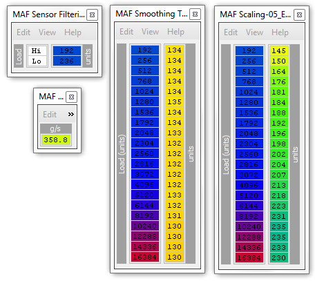

Those wanting to perform a 482 MAF swap on a non-turbo Lancer, you can use the values shown here, from a 2005 Eclipse GTS, as a starting point for your Lancer's ROM:
You can see that the values for the 482 MAF are sort of in between the values for the 2.4L 4-cylinder non-turbo 501 4G64 Eclipse MAF and the 2.0L 4-cylinder turbo'd 399 Evo MAF. To get this MAF to work on a non-turbo Lancer, proper datalogging and tuning will be required to adapt it to your individual engine setup.

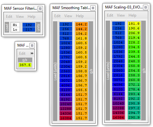

If your Lancer is turbo'd and you are opting to swap to an Evo 399 MAF, you can use the values from a 2003 Evo, shown below, as a starting point for your Lancer's ROM:
Values shown above for the 482 MAF can also be used as a starting point for Lancers if the Evo's 399 MAF values gives your engine idling issues.
Same steps and changes in EcuFlash apply for this MAF swap.
