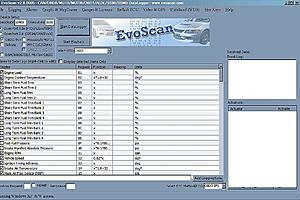

here's the info on idle in the attachment. as for the sas mode issues, i'm getting into sas mode fine...but there are no actuators to deal with...nothing i can see to adjust...i attached a pic of the screen so you can see. should i try an earlier version of evoscan? i don't have a gauge installed for afr yet, so i can't give any info on that...

The ISCV numbers are how much air to let in i think, although I've been told to think of it like "how hard does the engine need to try to stay idling"...anyway, the numbers you (and i until recently have) for the A/C on are less than the A/C off, which is backwards from what evo's have...and common sense tells us. Try, just for fun, increasing those values in the A/C on column, the last 2, to the A/C off numbers...and if it helps but doesn't fix it, maybe slightly higher than. Make sure she's nice and warm though.

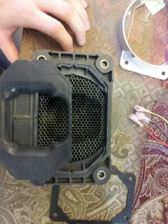

has anyone taken that lip off of the maf? i just took it off of the stock maf for the oz the 605 and it opens it up to where its a little bigger then the 482 maybe the same size if not bigger then the 399 and i put the values in for the 399 with the 605 maf in and it ran great idk why no one has done this before or if they have i just havent seen the post but this can save us a lot of money its like you have the evo maf already instead of paying the 150 for the 399
