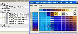

From what I Have been using, A maps have been G force vs Speed (kilometers). G force would be 0.0 to 4.0 range which is the voltage used to determine the G force load.
1.0 volts 1.5G Acceloration
1.5 volts 1.0G Acceloration
2.0 volts 0.5G Acceloration
2.5 volts 0.0G Neutral
3.0 volts 0.5G Deceloration
3.5 volts 1.0G Deceloration
4.0 volts 1.5G Deceloration
For A maps
Anything with ZERO is where the Delta between the front and rear axles will meet or are equal. Anything that is 1 or more (2,5,10,20) is the amount of degrees that the steering wheel will turn before both front and rear axles are equal. It will lock at that amount of degree input BUT only to be sure both axle become equal, Its NOT A FULL LOCK.
Example: at 2.6 volts or 0.1 G's, the steering wheel can be turned 2 degrees before it locks to be sure both axles are equal speed. As you decelerate harder to 3.0volts(0.5G), 3.7volts(1.2G), 5 degrees or even 20 degrees of steering input can be available. For that amount of degrees, it allows the wheels to be free. Power is free to go to the Front wheels (to pull) or free to go to the Rear(to push). If you Decelerate hard, there is very little weight at the Rear which can make the Rear wheels overpower the Front wheels(sometimes). So the ACD is OPEN longer to reduce Understeer and HOPE power gets delivered to the Rear!!!
On the STOCK Maps Tarmac is more Active then Gravel or Snow. In Gravel or Snow the ACD allows more Slips (Locks less frequently). On the Street, Gravel or Snow will allow the the car to be more Front Wheel Drive because the front tires make a Larger ARC while turning and the rear just drags and follows. Until the ACD starts to lock at 6 degrees or even 40 Degrees, the Rear matches the Front. At times, the Rear can overpower the Front. If the Rear overpowers the front (like with an upgraded REAR DIFF), it will take the same amount of steering degrees Input for the Rear to match the Front.
A Maps are Dominant and the condition will apply Unless B maps or C maps Say other wise.
The manufacture relied more on the A maps
B maps, C maps are limits
ALL other maps are Maximum Limits

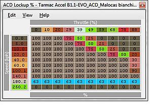

For B maps
The B maps have been Throttle input vs Speed(kilometers).
Anything with a ZERO in the plot charts is Full Lock. Anything that is 100 or less is the amount of slip that is allowed.
Example: A Map will make sure the front and rear are equal at a steering Degree input.
B Map can still allow 100% slip AFTER A Map makes sure that both axles Match each others ARC (DELTA). B Map can allow 75% slip or 50% slip or 25% slip or 0% slip(NO SLIP)
If ALLLLL B Map is 0% slip OR FULLY LOCKED, YOU can have BIND also WEIRD and SCARY understeer or oversteer.
100% Slip is needed!!!! At the right time, speed, and condition then you can use 70, 50, 20, 0 slip, and that can be useful.

Malocas, let me rephrase it to make everything clear for me...
Main maps are A-Maps G-Force vs Speed.
Value determines drivers Steering Degree Input at which ACD locks to some %% needed to equalize axles speeds. So generally it keeps both axles equal at any speed up to 1.9G, then as G rises, ACD is kept open at higher Steering Degrees.
Are you sure that X axis is correct? 4g is a really high number, actually that kind of G-force can be archieved on F1 cars..
B-Maps are Throttle input vs Speed. Value determines slip. Higher number - more diff slip, less lock.
So at 250kph ACD is fully locked??
C-Maps are Steering Degrees vs Speed. Value determines slip. Higher number - more diff slip, less lock.
In stock it keeps diff locked up to 10 kph at any Steering Wheel input, and keeps it fully open at any speeds higher than 40kph.
B and C maps act only after A-maps complete their job - equalize both axles.
Am I right?

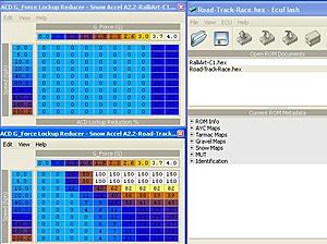

According to merlins most recent defs: Which table(s) if I want my snow map to be heavily locked under any acceleration or intended acceleration. I have a lot of ice / snow on the roads here and I want to tinker tehre first.

211, increase the values in the A-Maps for increased lock with throttle.
My best info atm is the A-Maps get multiplied with the B-Maps.

I did not want to comment on Molocas post as I disagree with some of the content.
At the moment, I stand by what I stated on the axis for the ABC maps, and the scalings used in the xmls, eg 1.5G not 4G, steering angle range of 360 degrees with a 2 degree resolution.
I dont think the B and C maps are limits, but rather multiplying factors with a range of zero to one, which is then applied to the A maps.
However, time will (hopefully) provide an answer.
