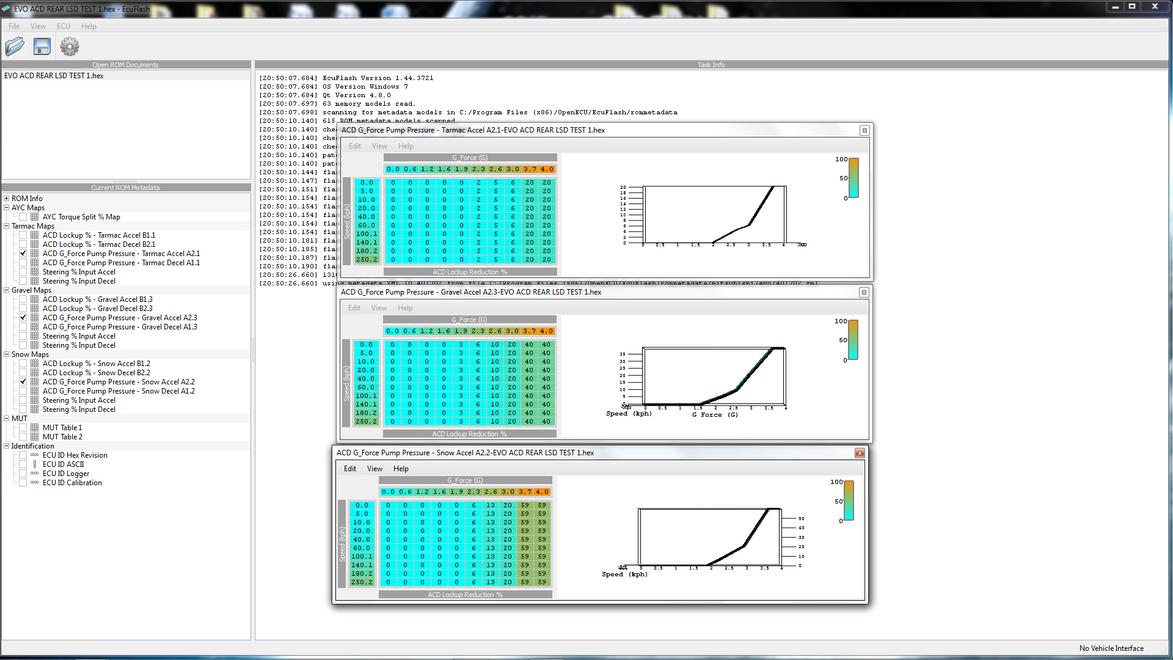

I've made this this kind of test:
First I set the upper pressure limit to 17 bar and logged the pressure value at idle with engine off: it works quite good, but I think the expasion vase ar at limit, I mean it could require a little air pressure more.
Strange thing: At idle, with RA K2 rom, I logged the current valve to ACD, it rise till 1000mA at wot; ok. Same test but with stock evo 8 or evo 9 (as Malocas) and that current rise only to 330mA, why??????
Second test: stock evo8 map with only this silly modify (wide open throttle i'd like non slip at low speed, (in the pict)), the car exit from slow turn is became incredibly understeering!! Why????

Malocas, let me rephrase it to make everything clear for me...
Main maps are A-Maps G-Force vs Speed.
Value determines drivers Steering Degree Input at which ACD locks to some %% needed to equalize axles speeds. So generally it keeps both axles equal at any speed up to 1.9G, then as G rises, ACD is kept open at higher Steering Degrees.
Are you sure that X axis is correct? 4g is a really high number, actually that kind of G-force can be archieved on F1 cars..
B-Maps are Throttle input vs Speed. Value determines slip. Higher number - more diff slip, less lock.
So at 250kph ACD is fully locked??
C-Maps are Steering Degrees vs Speed. Value determines slip. Higher number - more diff slip, less lock.
In stock it keeps diff locked up to 10 kph at any Steering Wheel input, and keeps it fully open at any speeds higher than 40kph.
B and C maps act only after A-maps complete their job - equalize both axles.
Am I right?

That is what Mitsubishi used. The G Sensor sits at 2.5 Volts constantly when the car is not moving.
If you touch or hit the brakes and the care Decelerate the Voltage RISES to 3.0Volts (which is 0.5 G forces of Deceleration). As you brake harder, even to a panic to the higher Gs, voltage RISES to 3.7Volts (1.2G force of Deceleration) or even 4.0Volts (1.5G force of Deceleration), the ACD will be OPEN longer based on what Degree is Plotted.
The intent is that when you brake, the rear can be free to twist or come around. Its hard to see that in the street but its possible. In Dirt, the back comes around more noticeable, so Gravel and Snow are much more free, in Hard Deceleration.
As you Accelerate the voltage DROPS to 2.3 volts( 0.2 G force of acceleration) or a hard acceleration through more power or a sharp swing around a high speed curve, the voltage can DROPS to 1.9Volts(1.1 G force of accelerate). The ACD will be CLOSED more often to be sure the front tires do not make a larger arc then the rear, the car will be more NEUTRAL while driving on acceleration.
1.0Volts (1.5 Gforce of Accelotation)
2.5Volts (0.0 Gforce, NO MOMENTUM )
4.0Volts (1.5 Gforce of Deceleration)
Remember momentum plays a big part, then how your suspension takes advantage of that momentum and how your tires will handle those forces.
With B Maps you are correct.
It does start to lock up at high speed and then fully lock at 250kph. It was for stability because if there was a little under steer at high speed, A Map will allow the ACD to open up and the Rear end can swing around. That can be a 250kph spin out!!!
With C Maps you are correct.
At low speed it is locked because the manufacturer probably didn't want power easily sent to the front. They wanted to be sure power was equal at low speeds at any condition to get up and go. Its also easier on the Center Differential.
***So are cars have a bad turn radius because of this, and now you know how to solve that but be careful with that center diff***
Above 40kph, in first gear, there is a lot of torque available. Slip becomes allowed in hopes that the weight can keep the front wheels planted to the floor and the rear wheels can brake traction.
ALL the maps are checking each sensor at a high resolution and calculating what is need almost instantly. So I say in the stock rom, A Map is dominant because the Voltage is jumping around just as much as the car shakes on a bumpy road. A Map is very dynamic! ......B map checks throttle: slip or no slip??? ......C map checks Steering: slip or no slip???
Its all in milliseconds!!! Electricity almost going the speed of light.
ACD Helps a lot with being stable, neutral, have less under steer.
The REAL secret to OVERSTEER is an Upgraded REAR LSD. EVEN with the Stock ROM ...amazing.
Having both is better.
