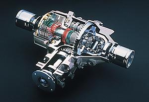

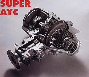

Oh I see my mistake now. Thanks guys!
Found two nice pics as an illustration.
Attached Thumbnails Tuning Evo789 ACD-ayc.jpg   Tuning Evo789 ACD-super-ayc.jpg
