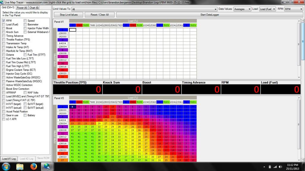

Hi guys, recently downloaded evoscan 2.9 and on the Graphs and map tracer mode the panel 1 and panel 3 LOAD and RPM axis does not reflect the actual loads like 10 to 260 and the RPM like 1000 to 7500 and 11000 like it normally shows on ECUflash. Am i doing something wrong.?

Did you right click in the lower graph area and load your rom?

Yep and it did load reflecting the fuel map and timing map but the axis stayed the same.

This is what i have

I am having the exact same issue, i loaded the rom but the LOAD and RPM values are not what they should be, just random numbers.

Xml must be in the same folder as your ROM

That is incorrect. There is something wrong with the definition file being used.

I put the hex file in the rommetadata evo folder of ecu flash and it showed the RPM and load correctly but a new issue came up.
I cant see the load values past 159. I previously logged with mitsulogger with loads reaching 180. I opened those logs in Evoscan but its all limited to 159 load. Running a stock JDM 93660005 rom.
