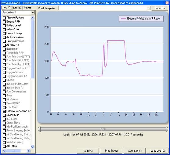

Hey All,
Im using EvoScan 2.4 and when opening up map tracer im only showing a single logged value (load cell 30 RPM 1000) for any value that even shows up (if it shows up)....and the graph is showing a weird scale for AFR (even though the realtime logged data is showing up as a correct AFR value such as 14.7 etc..)
Any insight is appreciated.
Attached Thumbnails EvoScan Logging a single load cell-pic1.jpg   EvoScan Logging a single load cell-pic2.jpg

This may be a dumb question but are you logging 2Byte load or the Load Calc value?

not a dumb question...i did make the 2byte load mods to my ECU (im a n00b and could have messed something up?)

actually, you should be able to see with the larger pic..that the MUT 2byte load was being logged at the time as well (although im not sure any cells really did get logged..)

What does the load in the csv file actually show in the 2byte load column

I have used 2.2, 2.3, and 2.4 2.2 and 2.3 i believe I had issues with the ZT-2 wideband logging and 2.4 it works but its on a weird scale. What is everyone using?? .99?
Mike,
I will check the csv's and see. In Chicago for work the whole week.

I was having this issue with v2.3 I figured it was due to the sampling rate bug that we were all seeing. I havent logged any pulls with 2.4 yet so I dont know

I just installed 2.4 and loaded up a log I took from the 2.3 beta and the map tracer is working fine.
I'll take a log with 2.4 on my way home tonight and see if I have issues with that.

thank you sir.....anyone have any idea why the scale on my wideband is so weird?

I am having 0 issues with 2.4 logging or reviewing the map tracer. I'll shoot you a pm with my email and you can shoot me your log just to test.
